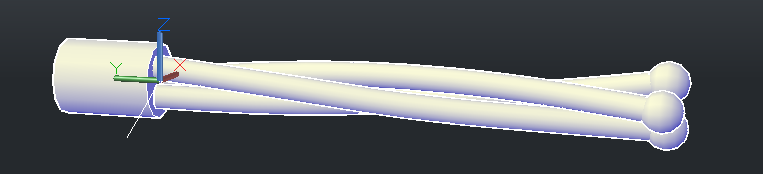

  3. I would start with a helix but then because the ends are splayed a bit I would trace over the helix to make a spline with 4 fit points. I would then move the end point out radially a bit to make room for the sphere. You can then use polar array to make the 3 legs. For the model below I set the helix height to 60 and the number of turns to 0.5. The circle I swept could be a bit larger.
