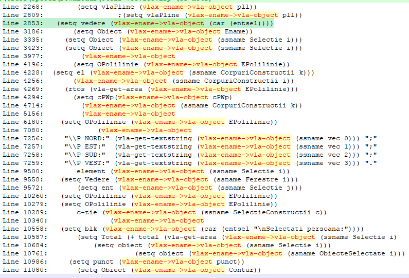

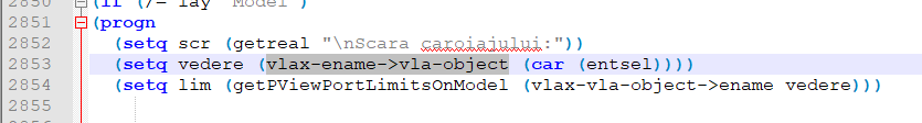

  1. Wow ronjonp found a problem on line 2853 you must have a lot of time. PG starts at line 8268 It looks like every single routine has been put into 1 routine, not sure what sort of memory overhead that introduces, as posted when something goes wrong where do you start particuarly if your not the author.

  3. On line 2853 .. if you miss a pick it will cause this error. You always need to make sure you're passing a valid ename to that function. Quick fix would be to include this sub in the code: (defun _vla-object (ename) (if (= 'ename (type ename)) (vlax-ename->vla-object ename) ) ) Then do a find and replace of 'vlax-ename->vla-object' with '_vla-object'.

  6. I spent about 2 minutes on the problem there are many other places this code can fail ... the OP needs to use break on error in the vlide to troubleshoot this. 11400 lines in the code posted!
