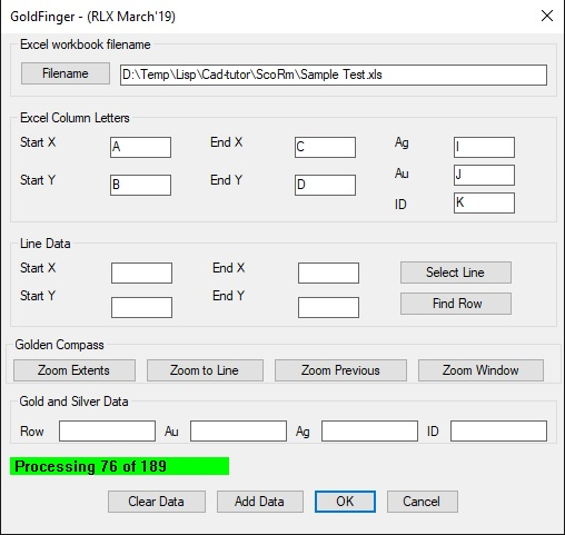

  7. Here in NL its just after midnight so while you are going to work I'll be soon be going to bed. Have also included a version with all coordinates concatenated , see if it works better / faster. Only way to find out is testing it on the real deal... While knowing what the future will bring , I still hope my parents will live forever but sadly that's not how it works... Goodluck with your project golddigger , euh goldfinger if you have any problems or questions let me know. think I'm gonna cash in on some of my overtime hours tomorrow gr. RLX GoldFinger.LSP

  8. OMG I am so excited to try this first thing in the morning! Thank you so much for helping me. and your question above, about coordinated in ABCD... yes it is always like that StartX StartY EndX EndY StartZ EndZ Length Angle For the Searching, Just a Thought. What if you concatenate all StartX StartY EndX EndY so you will have a unique single ID, my concern is, what if 2 totally different coordinates sums up with the same number? you are so amazing!
