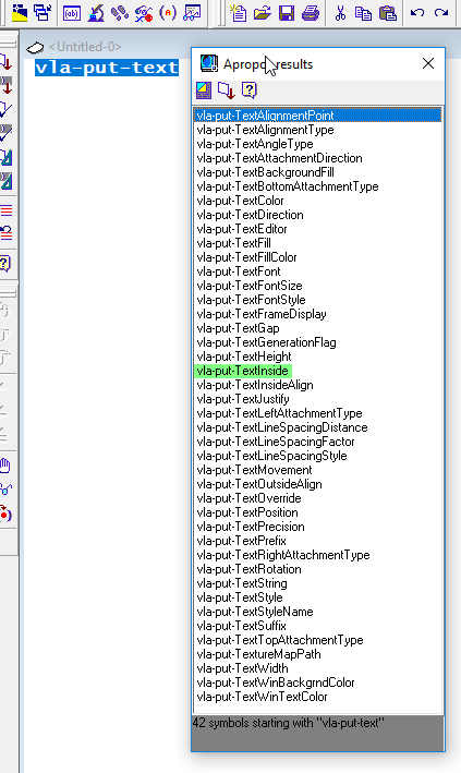

  1. Glad to help .. I used the VLIDE to find it: VLA-PUT-TEXT then CNTRL+SHIFT+A or CNTRL+SHIFT+SPACE
    2 points
