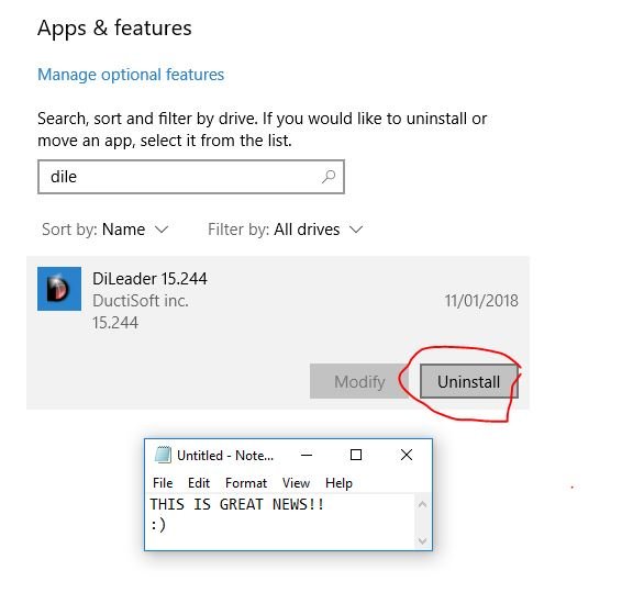

  1. Try running the native built-in ROTATE command. Does it fail to repeat with the space bar or <enter> also? Here is someone with a similar problem, he is running the ROTATE command (which is what you lisp is doing), and then the space bar or <enter> executes the SELECT command. It looks like an add-on is causing the issue

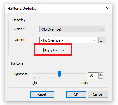

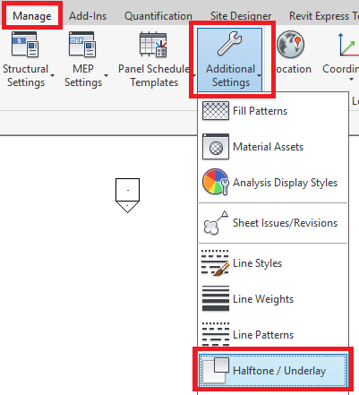

  9. First it's good to have an understanding of View Disciplines and how all six differ from each other. You can separate the View Disciplines into three different groups: Coordination, Architectural Structural Mechanical, Electrical, Plumbing All three MEP's work the same. They apply a halftone to non-MEP categories including Model Lines. Detail Lines do not show as halftone in MEP View Disciplines. But, this automatic halftone feature is actually a global setting shown here: This checkbox is the magic key: This is what controls the "automatic halftone" feature in the MEP View Disciplines. Turn this off and you can still apply Halftone to your Links via the V/G Revit Links Tab. So there's a tradeoff here and you'll have to try this global setting to see how you prefer your environment to be set up. Hope this helps. -TZ
