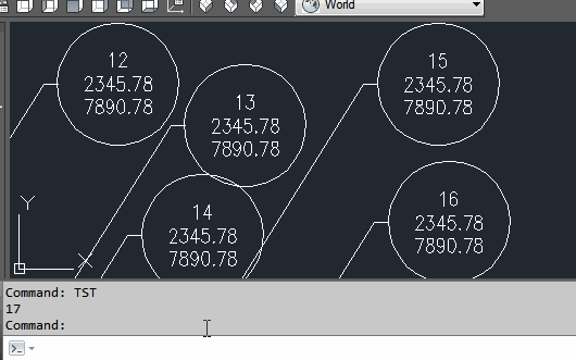

  2. You could also dig through the dict... Here, LSName being the mleader style name and tag being the tag we seek for... (defun c:tst ( / LSName tag mldict mlstyle maxval mlsdef interrupt subent mlssubents found tmp vlobj) (setq LSName "Standard") (setq tag "SEQ_NO") (setq mldict (cdr (assoc 350 (member '(3 . "ACAD_MLEADERSTYLE") (entget(namedobjdict)))))) (setq mlstyle (cdr (assoc 350 (member (cons 3 LSName) (entget mldict))))) (setq maxval 0) (if (setq mlsDef (entget mlstyle)) (foreach subent (setq mlsSubents (massoc 330 mlsDef)) (if (and (= (vla-get-objectname (vlax-ename->vla-object subent)) "AcDbMLeader") (setq tmp (massoc 330 (entget subent))) ) (foreach x tmp (if (and (= (vla-get-objectname (setq vlobj (vlax-ename->vla-object x))) "AcDbAttributeDefinition") (= (vla-get-TagString vlobj) tag) ) (progn (setq found (cdr(assoc 302 (member (cons 330 x) (entget subent))))) ;(alert found) (if (vl-every '(lambda (x) (< 47 x 58)) (vl-string->list found )) (setq maxval (max maxval (atoi found))) ) ) ) ) ) ) ) (if (not found) (princ (strcat "\n"tag " not found in " LSName" MLStyle")) ) (alert (strcat "Next leader should have a seq_no of " (itoa(1+ maxval)))) (1+ maxval) ) (defun massoc (key alist / x nlist) (foreach x alist (if (eq key (car x)) (setq nlist (cons (cdr x) nlist)) ) ) (reverse nlist) ) the vl-every make sure only numbers are taken in consideration. I take the max value found, and increment by 1 to determine the next one. Cheers.
