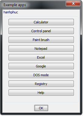

This routine allows you to create DCL with multiple buttons associated to DCL action_tile list on the fly.
It creates DCL box with single column x nRows of buttons, 'n' depends on the length of the 'action list'

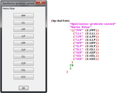

usage:
(hp:buttons title lst width ht)
title = Name caption on top of DCL - string
lst   = quoted list or progn list - list
width = Width of the dialod box - integer
ht    = height of each button - integer
returns nil or any execution (progn ... ) related to action_tile
