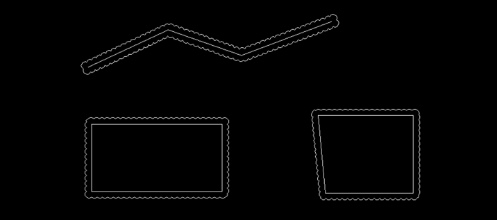

Hi all,
I'm trying to figure out if it is possible to use revcloud command to draw a revcloud around a (poly)line. I know you can use revcloud and select an object, but this converts the line to a revcloud line and only on one side. The goal is to simply use the command to select a line and it draws a revcloud around the line (on both sides) while retaining the object.
I know I can change the DELOBJ system variable but this also changes the behavior of other functions.
Is this something possible without LISP or only with LISP? Also it feels like this should be solved already but I cannot find the solution on the web. Hope someone can help me with this.

Hi Tsuky and BIGAL, thank you for your replies! Much appreciated. The code is way to advanced for me to understand whats going on. It does seem to do what I want except for two things
  • Somehow the arclength that is used as input is not used for the revcloud. Preferably it uses the default width (same as if you use the revcloud command without change the arclength)
  • It only works on polylines, if it's possible it would be nice to also be able to select normal lines
Is it possible to use same routine as the normal 'REVCLOUD->select object' command when selecting an object but then make two copies of the selected line/polyline, and apply the revcloud->object command twice (first time selected 'No' for the reverse direction query, and the second time 'Yes'). So the algorithm would look something like
1. Enter command
2. Ask for object selection
3. Copy selected object in it's place
4. Use on the copied object 'revcloud' -> object -> reverse direction:yes
5. Copy original object again
6. Use on the 2nd copied object 'revcloud' -> object -> reverse direction:no
Thats my current workflow, hope this makes sense.
