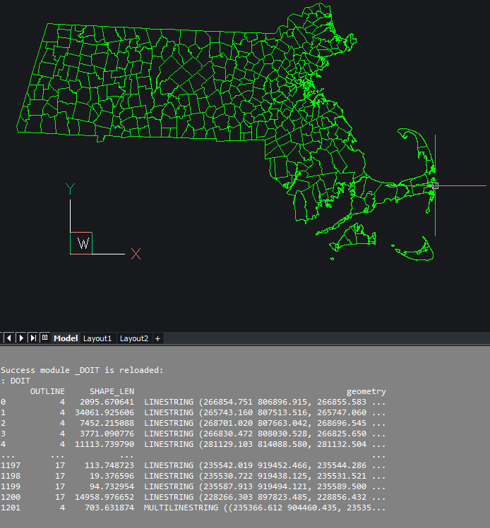

Python’s geopandas can read shp files.
Not sure if your program can run the wrappers I’m working on, or the additional data you need. Maybe a source of inspiration
import traceback
from pyrx_imp import Rx
from pyrx_imp import Ge
from pyrx_imp import Gi
from pyrx_imp import Db
from pyrx_imp import Ap
from pyrx_imp import Ed
from pyrx_imp import Gs
import geopandas
def makePline(pnts, model, color):
    pline = Db.Polyline(pnts)
    pline.setColorIndex(color)
    model.appendAcDbEntity(pline)
def PyRxCmd_doit():
    try:
        db = Db.curDb()
        model = Db.BlockTableRecord(db.modelSpaceId(), Db.OpenMode.kForWrite)
        gdf = geopandas.read_file("E:/townssurvey_shp/TOWNSSURVEY_ARC_GENCOAST.shp")
        #do MultiPolygon first
        gdf0 = gdf.loc[gdf.geometry.geometry.type=='MultiPolygon']
        for mp in list(gdf0.geometry):
            for p in mp.geoms:
                makePline(list(p.exterior.coords), model, 1)
        gdf1 = gdf.loc[gdf.geometry.geometry.type=='Polygon']
        for p in gdf1.geometry:
            makePline(list(p.exterior.coords), model, 2)
        gdf2 = gdf.loc[gdf.geometry.geometry.type=='LineString']
        for p in gdf2.geometry:
            makePline(list(p.coords), model, 3)
        print(gdf)
    except Exception as err:
        traceback.print_exception(err)
Edited by Danielm103
