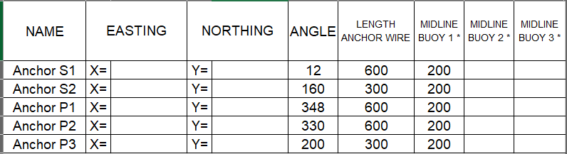

I know but S stands for Starboard Side and P for Port Side.
The S and P elements are (hidden) attributes in a block (which is a ship) representing an anchor location at the ship.
S1 and P1 for instance are Tag Names and also the default Values of the attribute objects.
The ship (in block mode) is always pointing to the North with the 0,0 origin at the stern (not necessarily in the middle)
With a sub routine, the WCS coordinates of the anchors are stored in a LIST for later use.
The insertion point of the attributes is actually the start point of an anchor line which is drawn
However the List order must be according to this table, which is used as an input to read in (the known) angle, length anchor wire data and possible mid line buoy distance.
But the table is also placed into the drawing, filled with the (calculated) anchor coordinates after setting them out with the (relative) angle and distance (length anchor wire).
Each ship/barge we use may have a different amount of Starboard Side and Port Side anchors, so S1 and P1 are always there, but the amount (= the number) may vary per ship/barge.
Now it would be easier if I changed the order (P1 first row) in the excel sheet, but my internal clients are a bit autistic 😉 ...they want to see the S anchors first in the table
For now I have changed the default values of the hidden attributes to A1 (for Starboard) and B1 (for Port), because this way the function of hanhphuc works.

Pfff....still struggling with this sub routine. Let me be more specific.
The goal of this sub routine is to iterate through all present attributes in a block, and list their value and wcs coordinate.
(defun getatt ( blk / enx )
    (if (and (setq blk (entnext blk)) (= "ATTRIB" (cdr (assoc 0 (setq enx (entget blk))))))
       (setq lst
            (cons
                (cons
                    (cdr (assoc 1 enx)) ; attrib value
                    (cdr (assoc 10 enx)) ; wcs coordinate
                (getatt blk)
The result list is:
((S2 239.209 265.528 0.0) (P1 259.56 341.311 0.0) (P2 256.249 342.843 0.0) (S1 271.666 335.713 0.0) (P3 223.721 272.691 0.0))
I deliberately created the attributes in a dis-order because users who will create these attribute blocks may do the same.
But the list should be ordered like this for later use:
((S1 271.666 335.713 0.0) (S2 239.209 265.528 0.0) (P1 259.56 341.311 0.0) (P2 256.249 342.843 0.0) (P3 223.721 272.691 0.0))
S items first followed by P items, because I want the coordinates to be listed in a certain order
The amount of S and P items may vary per attribute block
How do I do this efficiently?
If lst contains your list then
(setq lst (vl-sort lst '(lambda (x y) (if (= (substr (car x) 1 1) (substr (car y) 1 1)) (< (atoi (substr (car x) 2)) (atoi (substr (car y) 2))) (> (substr (car x) 1 1) (substr (car y) 1 1))))))
As S1, S2 ..P# are strings (attribute tags) and the (cadr) of each item in the list is itself a list (coordinates)
Edited by dlanorh
