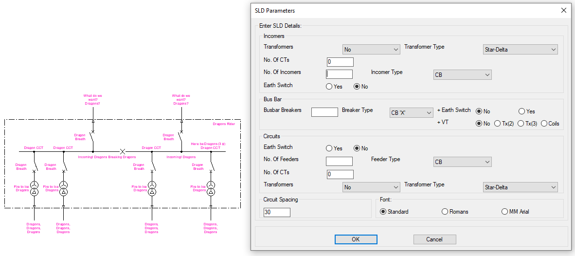

The first screenshot is pure LISP / VLA- / program generated, the user gets the dialogue box to input the data, here an electrical single line diagram / one line diagram and depending on the inputs the diagram is drawn. Code for this including the dialogue is about 1600 lines, plus there is coding to create the blocks in the diagram. I made this up one Christmas break to amuse myself and see if it could work. It can work well if as below the drawings follow a standard layout, we can use rules to create what we need to do. Something like a building layout, a road or similar where we need to consider the interaction between what we are interested in and the rest of the world become a lot more tricky. Then drafting become more an art than a science.
The no? No I can't share this.
