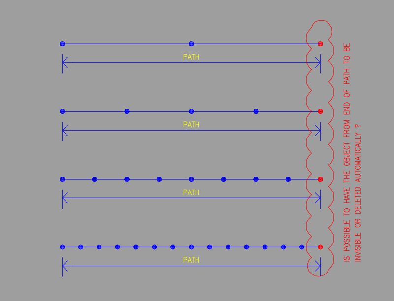

Hello everyone,
Is possible to help me with an ideea ?
I have some arraypath that i would like to have drawn without last element in the row visible... either visible or deleted would be fine.
Cant make array path shorter cause i need it to reach a bit far from last item.
I made array with "divide" method so not by "measure"
Thank you for your time.
DanPATH1.thumb.png.ac5f27bcbdf7a298c737e850e50d4499.pngPATH2.thumb.png.3ebf2a58f1d0b2f808aeabddd2933154.png
If you use a lisp can do what you want as the lisp could work out all the positions say along a line. It would be a simple repeat function for the donuts. Could use polar function to work out next point.
If you clarify what the object being added is some one will supply code very quickly.
BIgAl, not sure this works (weekend and all that, CAD is (mostly) off to test), create array, delete entlast ? if the last item created is always the end of the array, lower right corner in the above examples (which is what I'd need to check)?

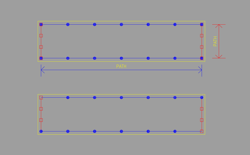

ideea is i need the array into a block .. actually i used 4 arrays for each side of the kolomn so that i can use stretch in both directions (horizontal and vertical)
I use method (for the number od donuts) divide cause i need to teel each time different number and i need them at same distancealong the path.
For the number of donuts i made a separate function so it can be seen in proprieties list of the blok.
All works fine for the blue donuts... cause is not important if last donut overlay on first of next line... , but as you can see in .dwg in attachment, the red circles that i need also have the problem of last one sticking out
i see that array has an start and end point option... i tried to put there a formula (expression) but is not allowed ...
So if you guys can think of a solution that last element of an array is not seen.. i would be greatful
ty
2.5cm koloms - test2.dwg

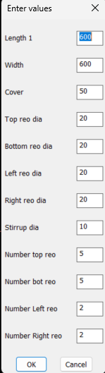

image.png.e56858e7121b48373ec2510d9791a047.pngMulti GETVALS.lsp

And I found a solution actually verry simple... i just press Ctrl + item i would like to delete from array and erase it..
Ty for all your replyes

the detail I was trying to generate is a cross-section for a concrete column.
blue donuts are the rebars in column
the red onew are waiting rebars in the lower area... and i needed them to be placed near the blue dots cause when im generating details i am counting those also no matter where section trough kolom is imagined.
I thik a lisp could work for a array routine but i dont know how to make one, or if possible to have a lisp that generates a different number for horizontall bars from the vertical bars..
And for DCL i didn use any custom so far, cause i dont know how to generate them... usually i make blocks and a lot of elements that i select trough method of visibility... I know very rudimentar :)
ill try DCL you recomended and see if helps me
ty very much

I tried to delete entlast.. but the array is working weird.. also with the method CTRL+item i needed to delete is not working, cause if i have an array of 3 items for example and delete last one is oke, but when i need 5 items on the array it delete the 3rd one :)  so basically i deleted then first one in the row and this way works. I can stretch , rotate or mirror it and still keeps first one deleted.
